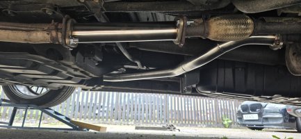

Fitted Zaustworx decat pipes to replace rear cats. Something I've been planning to do for the 5yrs I've had the van, a 2005 E51.
Don't sound much different from inside, haven't done enough miles to say if there's any mpg difference.
The pipes are very well made, come with gaskets and nuts/bolts. Pretty straightforward to fit on both pipes.
NB the cats I took off looked immaculate. My van is a camper conversion and we don't use it for short journeys so probably avoid most of the issues with cat degradation/blockage.
Very happy.

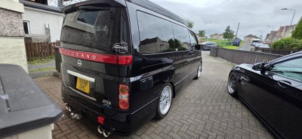

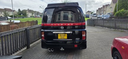

MOT due Thursday. I had an advisory on a rear reflector last time and in my typical procrastination, I forgot.
Using the guide on here, along with loosening off most of the rear bumper (S1 impul body kit) I removed the rear cluster, hoping to pop open the lense cover, clean and win easily.
Oh no though... Plastic so old and brittle it's impossible to open the clips without breaking them all.
But, I soon realised it was water ingress that was making the reflector dull.
Drilled a small hole and out ran the water.
Reflector almost perfect now so hopefully no problem on Thursday.
The water was getting in due to a crack in the rear cluster so I'll be looking for one soon...
Water ingress is such a pain with these older rear clusters - once it gets in there it just sits and makes everything look cloudy. Drilling the drain hole was a smart move, I've done that myself before and it usually does the trick for the MOT. Shame about the clips being so brittle though.

Yup. Now on the look out for a new S1 HWS cluster. Rocking horse poop anyone??
