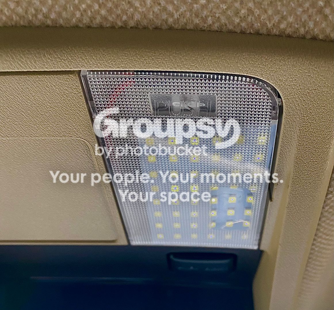

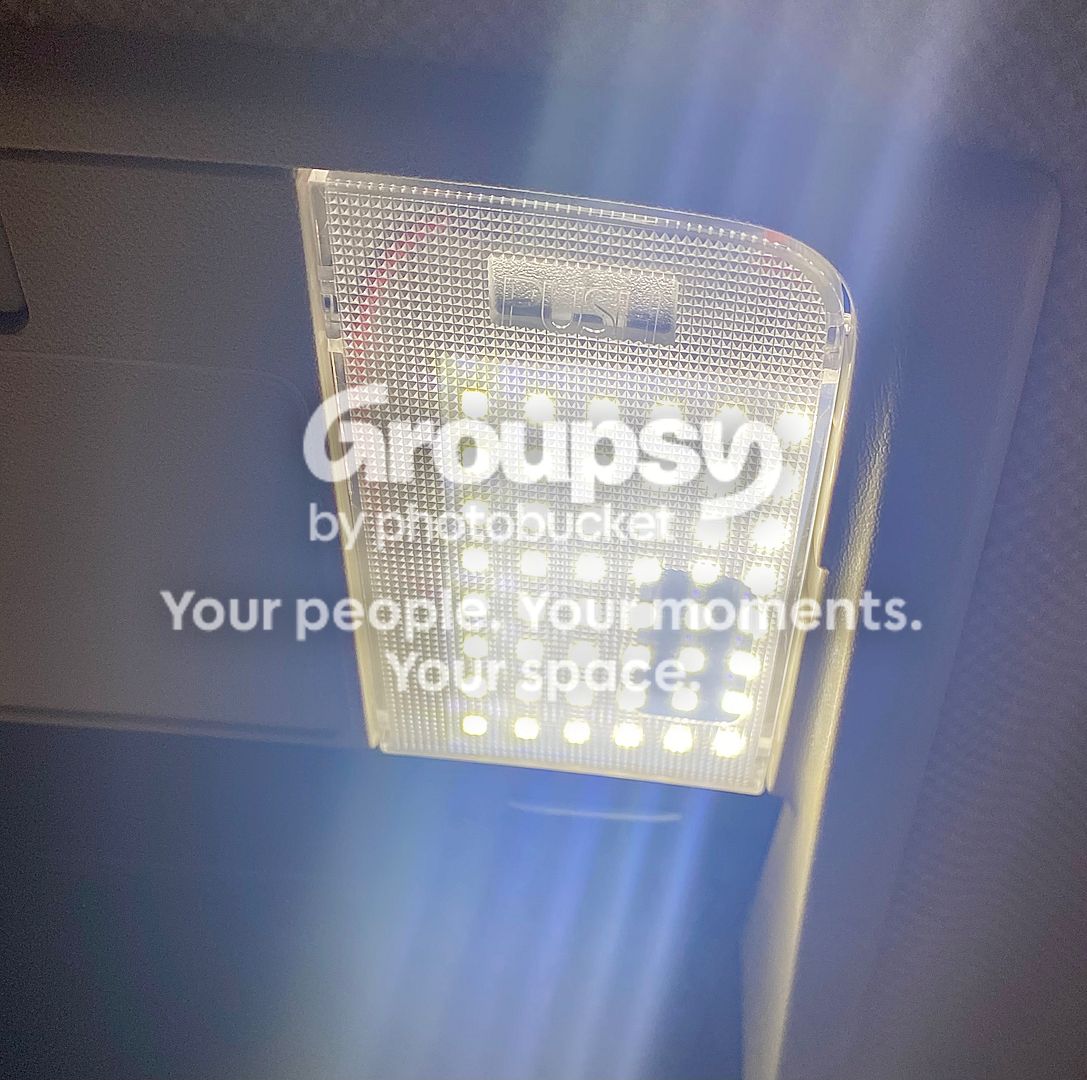

Did you buy them as a pack @Rayc ?Swap out all interior courtesy bulbs for LED,s & fitted a cargo net across the back for all the junk we carry around ...
View attachment 69477View attachment 69475View attachment 69476

I did the LED upgrade and I’m happy with them all, but the front cabin lights glow, even when they are off.Swap out all interior courtesy bulbs for LED,s & fitted a cargo net across the back for all the junk we carry around ...
LEDs are also photoreceptors, they also maybe picking up residual current caused by inductance.
