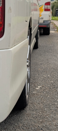

I adjusted it as far as it would go, yes I have HD springs+ stuff
