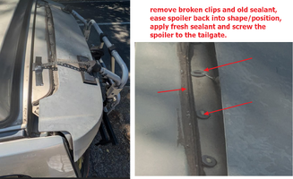

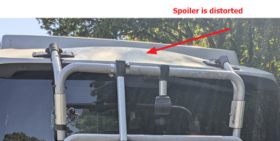

  • As can be seen by the pics below, the downward pressure of the 'bounce' has dislodged the rear spoiler. It being MOT day tomorrow, I've left all in place as the rear wiper and high level brake light still work, but post MOT it'll be a repair of some sort.
  • Hoping that the spoiler will recover its shape somewhat, my initial thoughts are to clear off the old sealant, remove the broken clips and reposition the spoiler and fix it in place with something like Sikaflex 512/522 or the like and even go as far as screwing through the spoiler into the underlying metal of the tailgate.
  • This won't be the prettiest of fixes but I'm not overly fussed about that on my 2002 E51 (which I'll likely keep until either of us dies ). Obviously using Sikaflex as the sealant would make subsequent removal of the spoiler difficult, but having a sound and firm fix is uppermost in my thinking.
  • And on that point, I'll also put a screw through each of the metal straps to stop them jumping out again.

Just a follow-up on my post:
> On removing the bike rack the spoiler just hung loose, held in place by the wiper mech and cabling.
> All the small retaining clips had broken and clearly the spoiler had only only stayed in place because the two large clips (one of them indicated by the green arrow in the pic below) either side had held their position by virtue of the bike rack itself.
> The spoiler did however recover its original shape immediately
The Fix
> I removed all the broken small clips and scrapped away the sealing strips along and under the top edge of the spoiler followed by a rigorous clean
> Then followed a good application of Sikaflex 522 sealant to the top underside edge of the spoiler to in effect substitute for the small clips - note; I masked off surrounding areas to prevent the Sikaflex going anywhere other than intended.
> The spoiler was then eased back into position ensuring the two large clips either side of the spoiler engaged(the green arrowed one) and whilst held in position I drilled pilot holes for self tapping screws to firm fix the spoiler in place
> I allowed 24hrs drying time for the sealant and then remounted the bike rack but crucially this time I screwed the upper hooked straps to the spoiler to prevent them accidently unhooking again.
> I load tested the rack by sitting on it and given that I'm about 3-4 e-bikes heavy and there was no movement or flex in the spoiler,I'm happy
Not the prettiest fix I know, but we're off to France in a few days time and my confidence in the rack and how it attaches to the vehicle has been restored.
